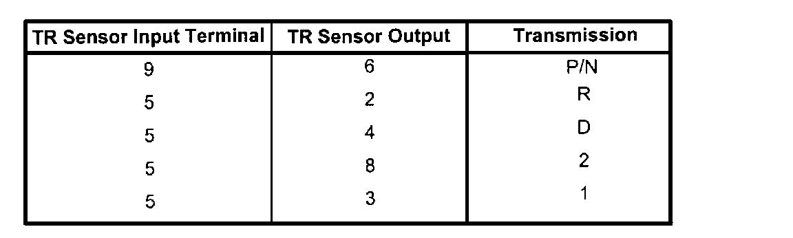

F3 Check The TR Sensor
Measure the resistance between TR sensor terminals with the gearshift selector in the indicated position, as shown.
Transmission Range Sensor Inputs:
Are the resistances less than 5 ohms?
