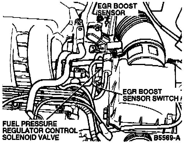

EGR Boost Sensor:
5. Remove the Exhaust Gas Recirculation (EGR) boost sensor switch bracket bolt and the EGR boost sensor bracket bolt from the RH side of the air cleaner housing cover and position them out of the way.
