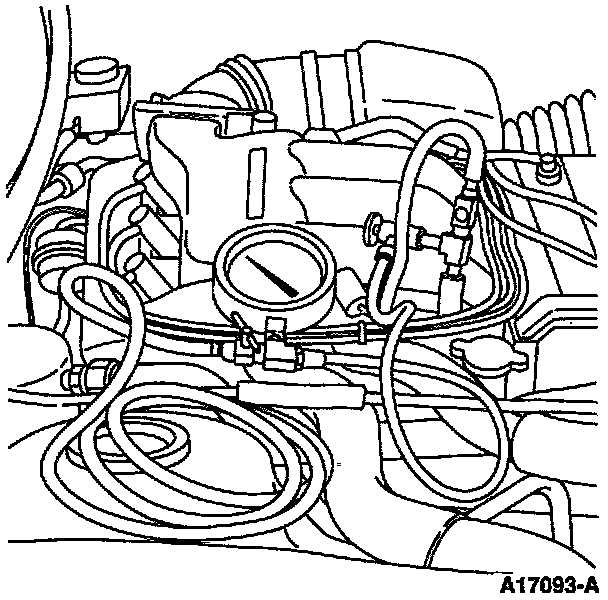

Fuel Pressure Test Setup:
2. Install a suitable fuel pressure test gauge.

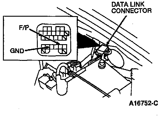

Fuel Pump Test Connector:
3. Jump the fuel pump test terminal to ground.
