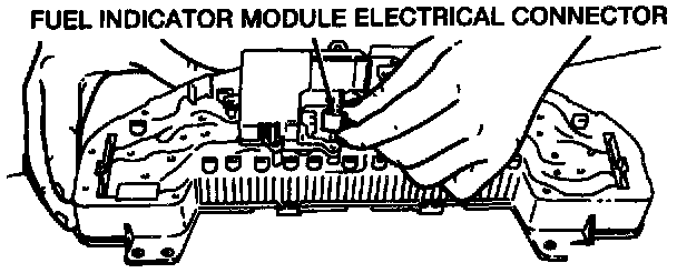

REMOVAL1. Remove the instrument cluster.
2. Remove the two fuel indicator module plastic cover screws.
3. Flip the lower right corner of the plastic cover up and disconnect the fuel indicator module electrical connector.
4. Remove the fuel indicator module.
