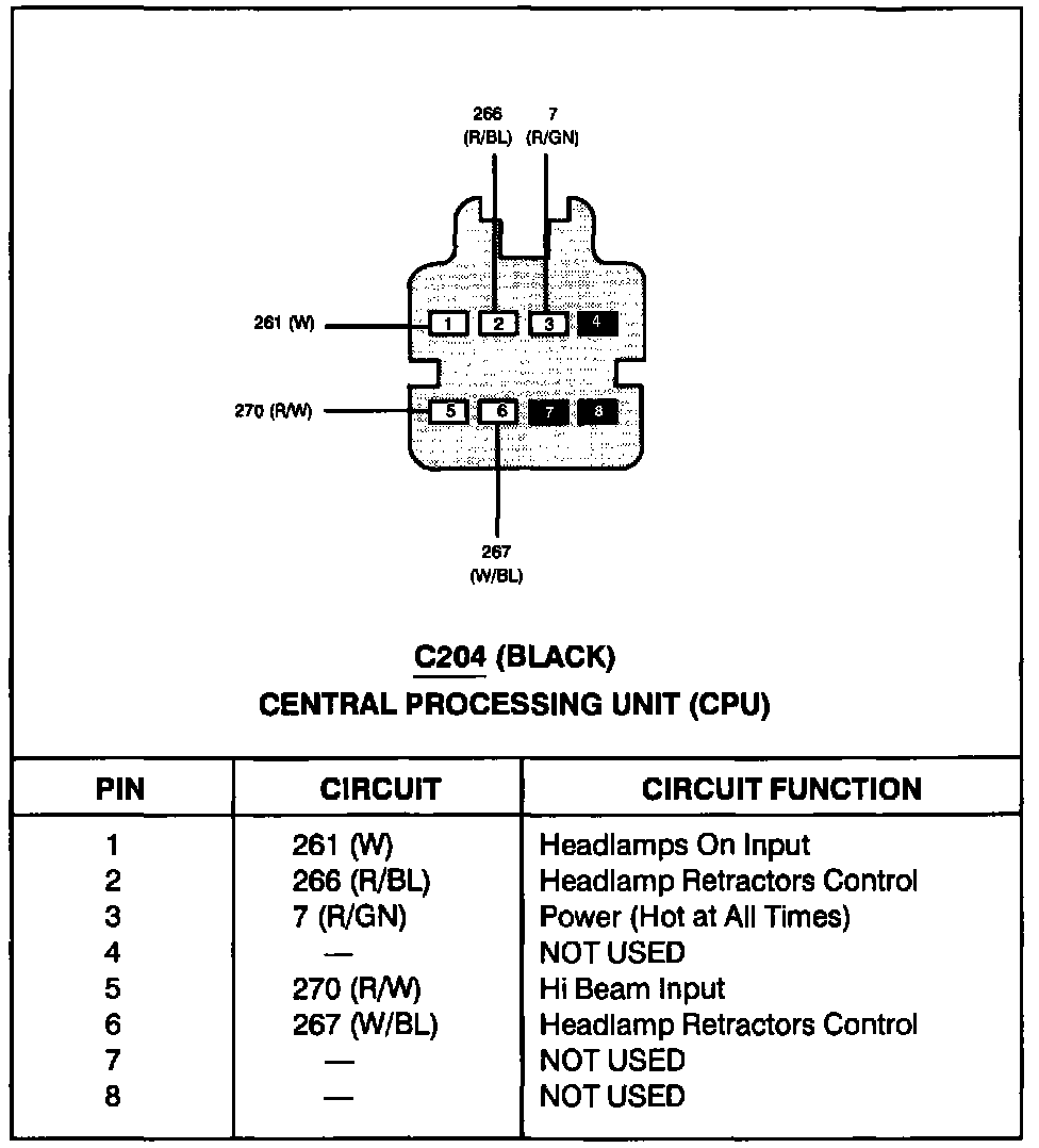

Headlamp Control Module
Headlamp Control Module: Diagrams
Central Processing Unit (C204):
