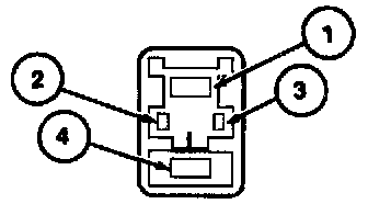

2. Remove the parking lamp relay.
3. Apply 12 volts to the 1 and 3 terminals at the parking lamp relay.
4. Measure the voltage of the 4 terminal at the parking lamp relay under these conditions:
2 Terminal Voltage On 4 Terminal
Grounded Greater than 10 volts.
Open Less than 1 volt.
5. If the parking lamp relay is OK, return to the pinpoint tests. Pinpoint Tests
6. Otherwise, replace the parking lamp relay.
