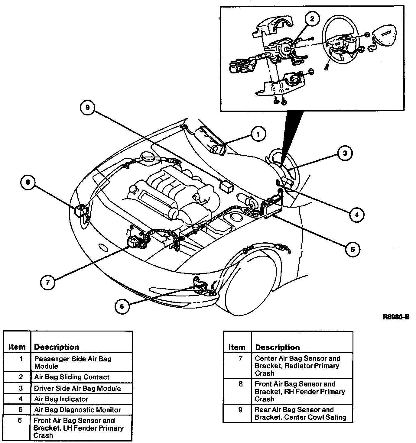

The supplemental air bag restraint electrical system consists of:
- Driver side air bag module
- Passenger side air bag module
- Air bag sliding contact
- Front air bag sensor and bracket, LH fender primary crash
- Front air bag sensor and bracket, RH fender primary crash
- Center air bag sensor and bracket, radiator primary crash
- Rear air bag sensor and bracket, center cowl safing
- Air bag diagnostic monitor
- Air bag indicator
- Tone generator (internal to the air bag diagnostic monitor)
