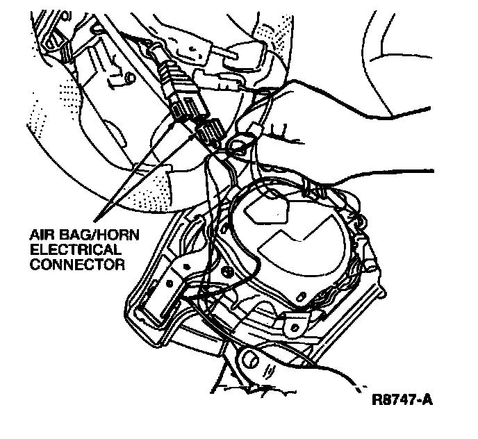

2. Remove the four driver side air bag module bolts from the back of the steering wheel.
3. Disconnect the air bag/horn electrical connector.
4. Disconnect the speed control electrical connector, if equipped.
5. Remove the driver side air bag module from the steering wheel.
