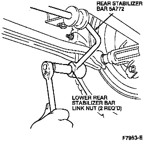

2. Remove the two lower rear stabilizer bar link nuts.

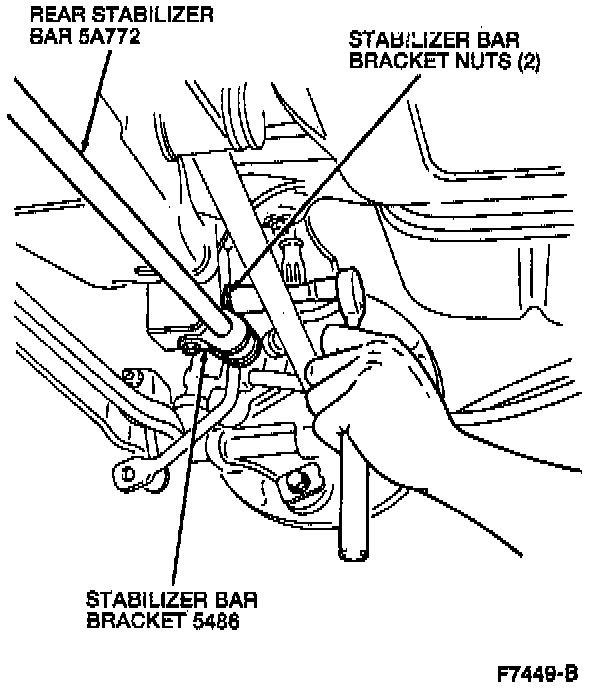

3. Remove the two stabilizer bar bracket nuts.
4. Remove the two stabilizer bar bracket bolts.

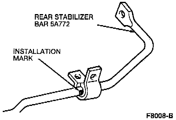

NOTE: Apply rubber grease to the inside surface of the lower suspension arm stabilizer bar insulators. Align the lower suspension arm stabilizer bar insulators with the installation marks on the rear stabilizer bar.
To install, reverse the removal procedure noting the following:
^ Tighten the lower rear stabilizer bar link nuts to 36-54 Nm (27-40 ft. lbs.).
^ Tighten the stabilizer bar bracket nuts to 36-54 Nm (27-40 ft. lbs.).
^ Tighten the stabilizer bar bracket bolts to 36-54 Nm (27-40 ft. lbs.).
