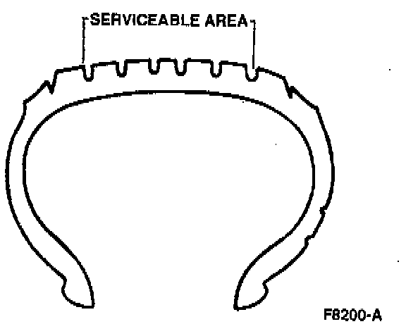

^ Punctured tires should be removed from the wheel and permanently serviced from the inside using a combination service plug and vulcanized patch. When servicing a puncture, always follow the manufacturer's instructions for using the service kit.
^ Service punctures that are in the tread area only. Never attempt to service punctures in the tire shoulders or sidewalls. In addition, do not service any tire that has sustained the following damage:
