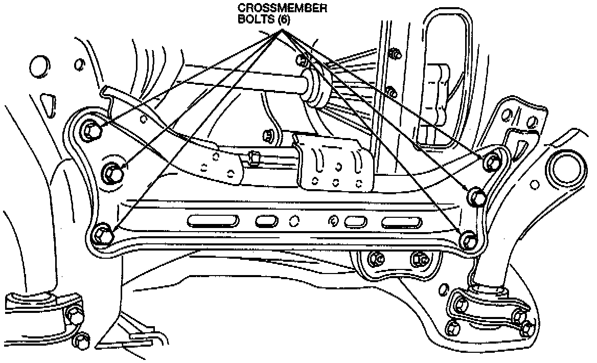

27. Remove the six cross member bolts.
28. Remove the cross member.
