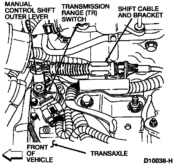

CAUTION: Apply the parking brake and block the wheels prior to removing the shift cable and bracket.
4. Remove the transmission shift cable from the manual control shift outer lever. Use a screwdriver or suitable tool to pry the shift cable and bracket from the manual control shift outer lever.
5. Disconnect the Transmission Range (TR) sensor electrical connector.
6. Loosen the two TR sensor bolts.
7. Rotate the TR switch until the neutral mark lines up with the TR switch shaft as shown.
