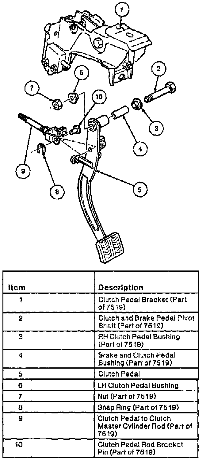

Clutch Pedal Assembly: Service and Repair
Delete:
REMOVAL
1. Disengage the brake pedal return spring from the clutch pedal.
2. Remove the snap ring from the clutch pedal rod bracket pin.
3. Remove the clutch pedal rod bracket pin from the clutch pedal to clutch master cylinder rod.
4. Remove the clutch and brake pedal pivot shaft and nut.
5. Remove the RH and LH clutch pedal bushings and the brake and clutch pedal bushing from the clutch pedal.
6. Remove the clutch pedal from the vehicle.
