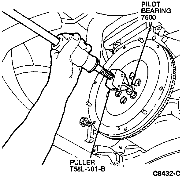

5. Inspect the pilot bearing for excessive wear or scoring, and replace if necessary. Remove the pilot bearing using Puller T58L-101-B.
NOTE: Do not remove the pilot bearing if it is not necessary.
