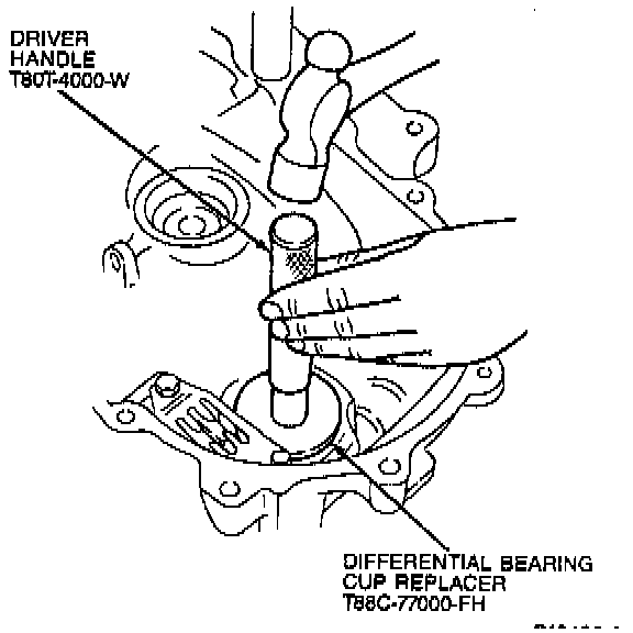

1. Install the differential bearing cup into the flywheel housing using Driver Handle T80T-4000-W and Differential Bearing Cup Replacer T88C-77000-FH.
2. Inspect the bearing cups after installation to make sure they are fully seated.

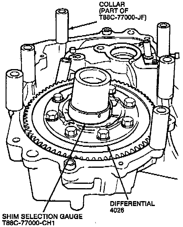

5. Position Shim Selection Gauge T88C-77000-CH3 (part of T88C-77000-C) on top of the differential.
NOTE: The gauge halves must be turned to eliminate any gap between them.
6. Place the six collars (part of T88C-77000-JF) on the flywheel housing.
NOTE: The six collars (part of T88C-77000-JF) should be placed at the same locations on the flywheel housing as explained in the input shah shim selection procedure, described.
7. Place the transaxle case on the collars and then install the washers and bolts (part of T88C-77000-JF). Tighten the collar bolts to 38-51 Nm (28-38 ft lbs.).
8. Adjust the gauge tool (using the pins provided in T88C-77000-JF) until the free play is removed and the bearing cup is seated. Thread the gauge tool halves back together.

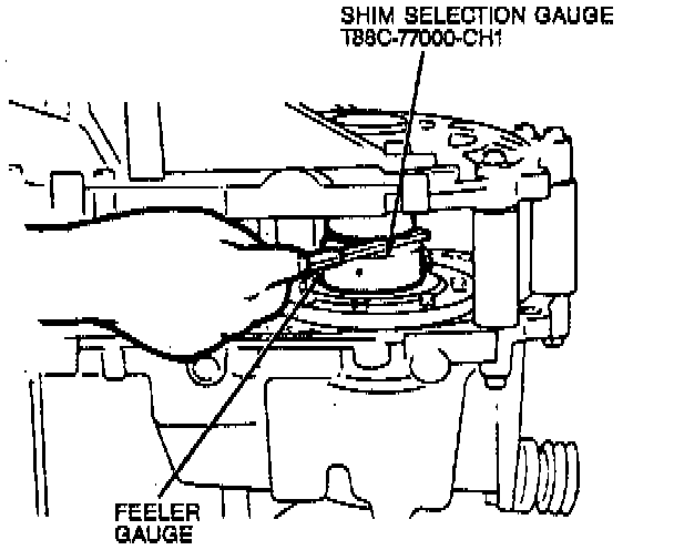

12. Use a feeler gauge to measure the gap in the shim selection gauge. Measure the gap in four locations at 90° intervals. Use the largest measurement.
13. Add 0.15 mm (0.0059 inch) to the measured clearance.
