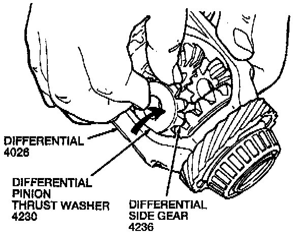

3. Remove the differential pinion gears and differential pinion thrust washers by rotating them out of the differential.
4. Remove the differential side gears and differential side gear thrust washers.

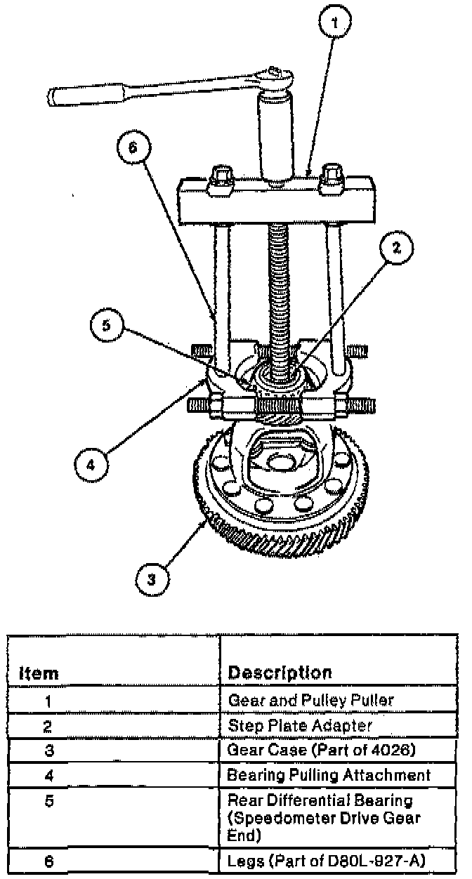

5. Use Gear and Pulley, Pull D80L-522-A Step Plate Adapter D80L-630-3 (part of D80L-630-A), Bearing Pulling Attachment D84L-1123-A, and the Legs from Push-Pull Set D80L-927-A or equivalents to remove the rear differential bearing (speedometer drive gear end).

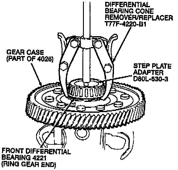

7. Use Differential Bearing Cone Remover/Replace T77F-4220-B3 and Step Plate Adapter D80L-630-3 (part of D80L-630-A) or equivalent to remove the front differential bearing (ring gear end).

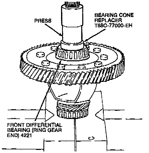

1. Use either Driver Handle T80T-4000-W or a press, and Differential Bearing Cone Replace T88C-77000-EH to install the speedometer drive gear and rear differential bearing.
2. Use either Driver Handle T80T-4000-W or a press, and Differential Bearing Cone Replace T88C-77000-EH and install the front differential bearing (ring gear end).
