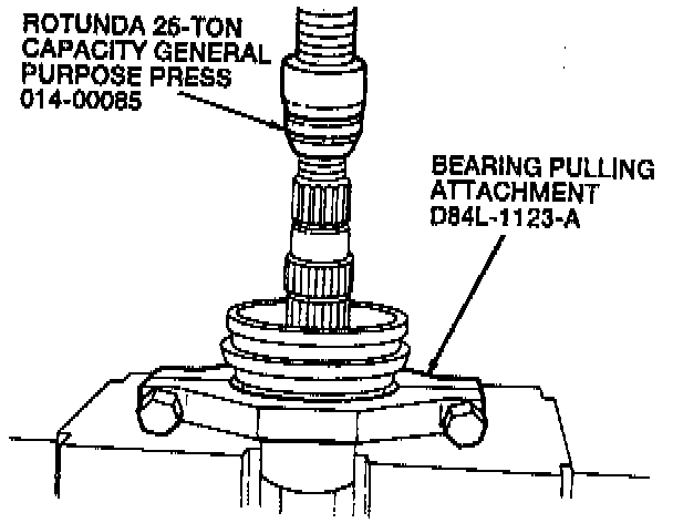

9. Use a Rotunda 25-Ton Capacity General Purpose Press 014-00085 and Bearing Pulling Attachment D84L-1123-A or equivalent to remove the bearing (fourth gear end).
CAUTION: Hold the input shaft with one hand so that it does not fall.
10. Remove the fourth gear from the input shaft.

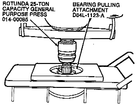

15. Use the hydraulic press and Bearing Pulling Attachment D84L-1123-A or equivalent to remove the third gear from the input shaft.

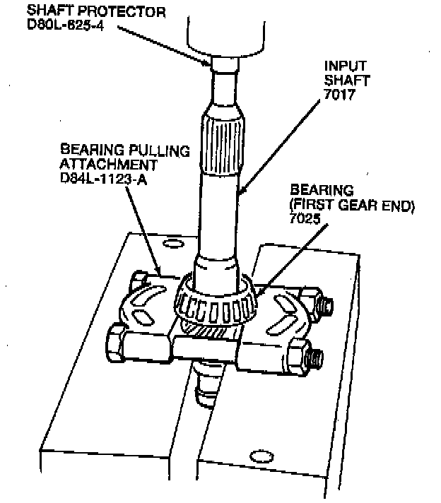

16. Use Bearing Pulling Attachment D84L-1123-A and Shaft Protector D80L-625-4 or equivalent to remove the bearing (first gear end) from the input shaft.
