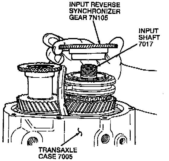

10. Remove the input synchronizer spacer from the top of the input reverse synchronizer gear.
11. Remove the input reverse synchronizer gear.

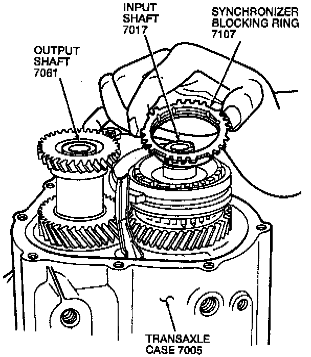

12. Remove the synchronizer blocking ring.

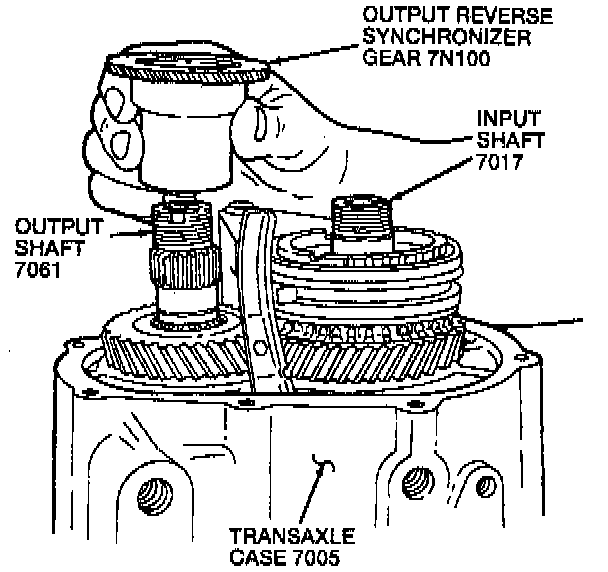

13. Remove the output reverse synchronizer gear.

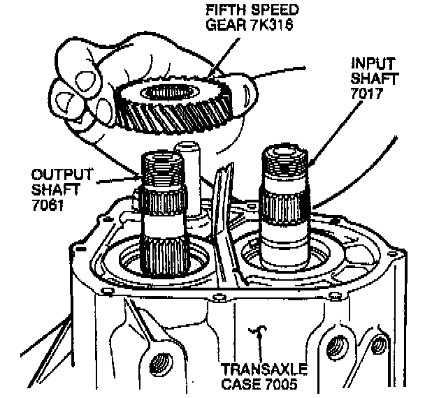

18. Remove the fifth speed gear from the output shaft.

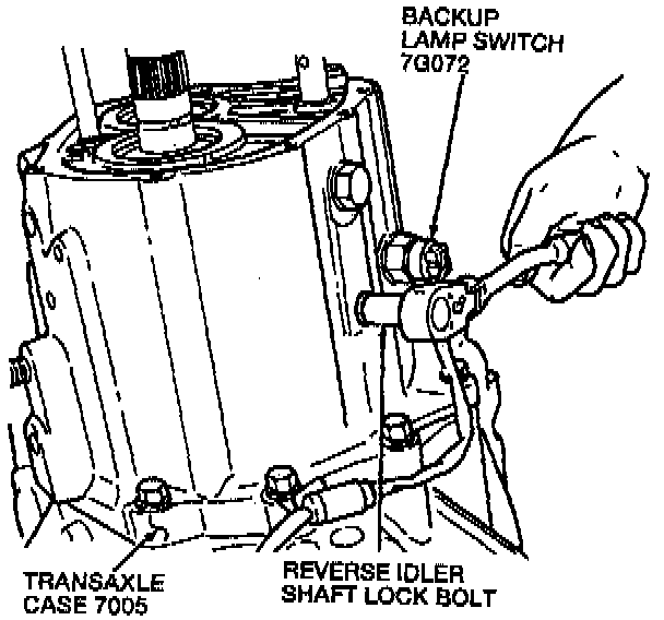

19. Remove the reverse idler shaft lock bolt from the transaxle case.

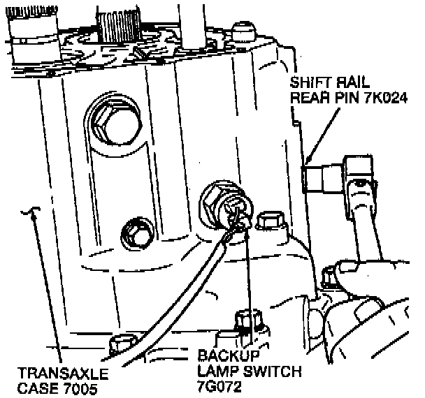

20. Remove the shift rail rear pin from the transaxle case.

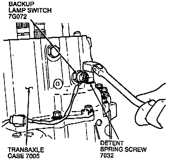

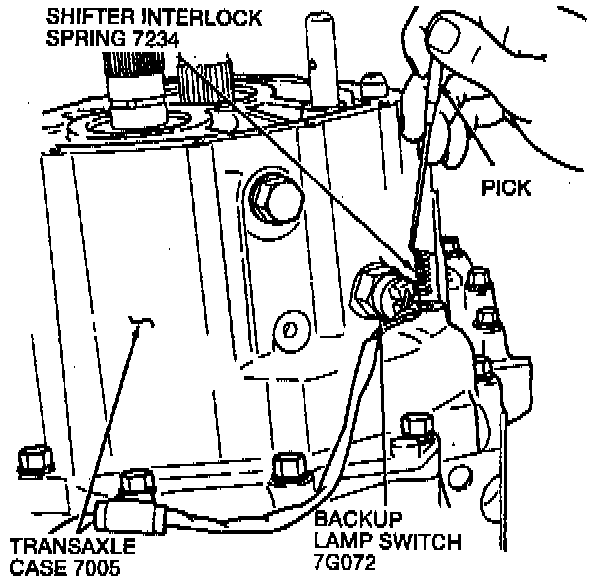

21. Remove the detent spring screw, shifter interlock spring and the ball from the transaxle case.
NOTE: If the ball cannot be removed at this time, it may be removed when the transaxle case is removed from the flywheel housing.
22. Remove the backup lamp switch from the transaxle case. Discard the copper washer.

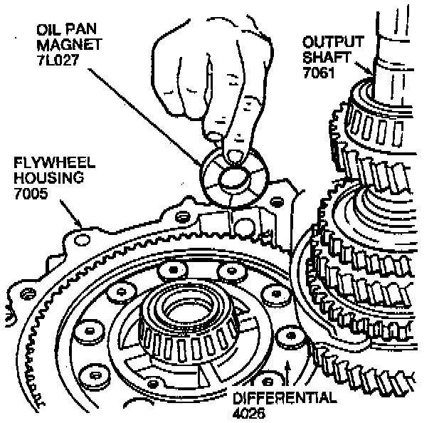

25. Remove the oil pan magnet from the side of the flywheel housing.

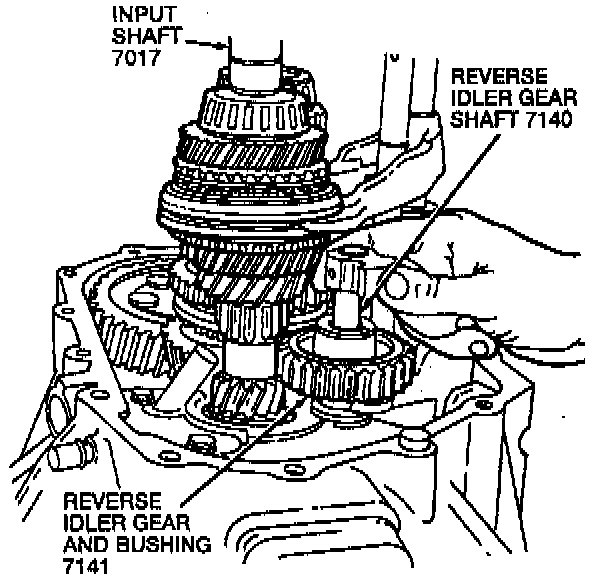

26. Remove the reverse idler gear and bushing and the reverse idler gear shaft from the flywheel housing.

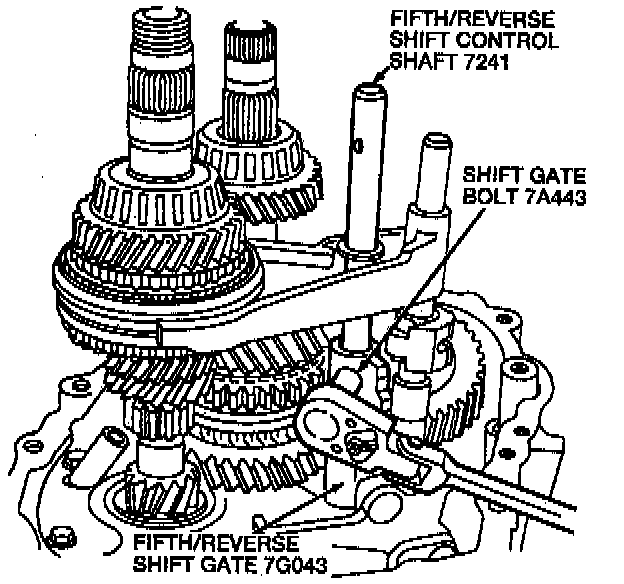

27. Remove the shift gate bolt from the fifth/reverse shift gate.
28. Remove the fifth/reverse shift control shaft.
29. Remove the fifth/reverse shift gate.

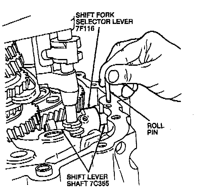

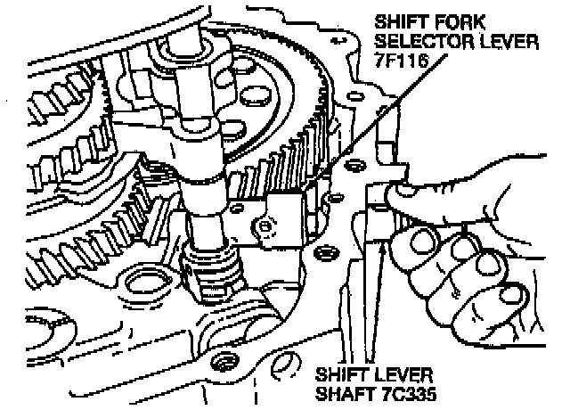

30. Remove the roll pin from the shift lever shaft. Discard the roll pin.
NOTE: The roll pin inserts into the shift lever shaft through the flywheel housing.
31. Carefully pry the shift lever shaft from the flywheel housing.
32. Remove the shift fork selector lever from the shift lever shaft.

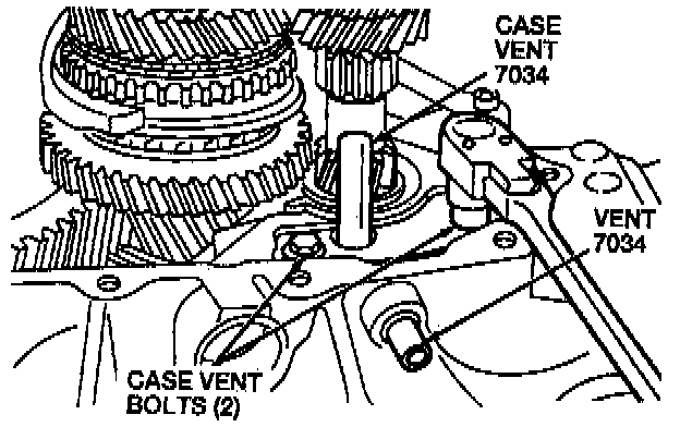

33. Remove the two case vent bolts and the case vent.
34. Remove the vent.

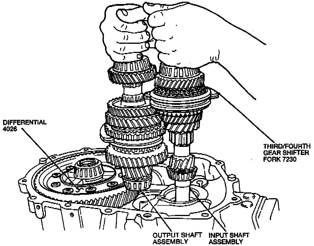

35. Remove the third/fourth gear shifter fork and main shift control shaft along with the input shaft and output shaft assemblies.
36. Remove the differential from the flywheel housing.

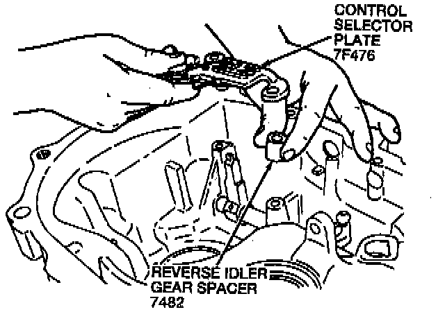

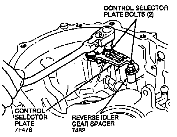

37. Remove the two control selector plate bolts, then the control selector plate and the reverse idler gear spacer.

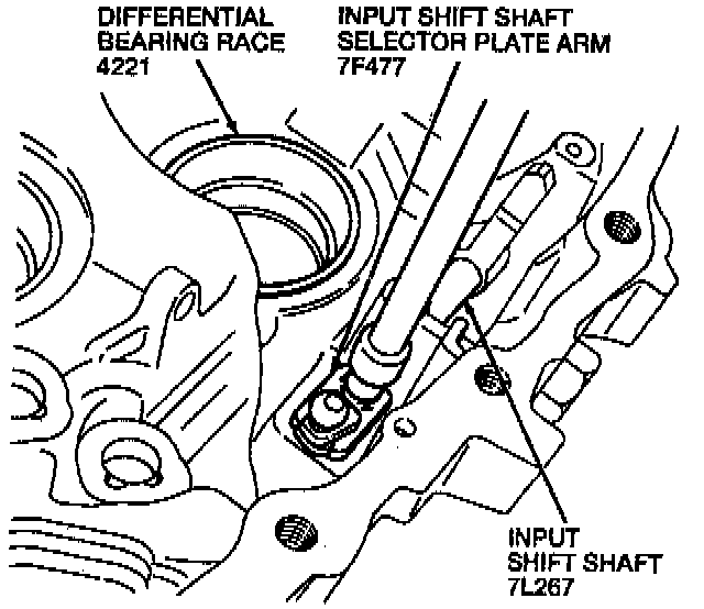

38. Remove the bolt attaching the input shift shaft selector plate arm to the input shift shaft.
39. Remove the input shift shaft selector plate arm from the flywheel housing.

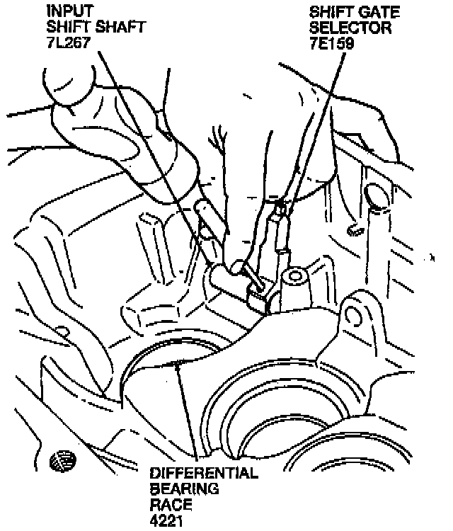

40. Remove the roll pin from the shift gate selector. Discard the roll pin.
41. Slide the input shift shaft from the flywheel housing and remove the input shift shaft selector plate arm and the shift gate selector.

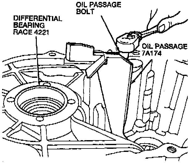

43. Remove the oil passage bolt, and remove the oil passage from the transaxle case.

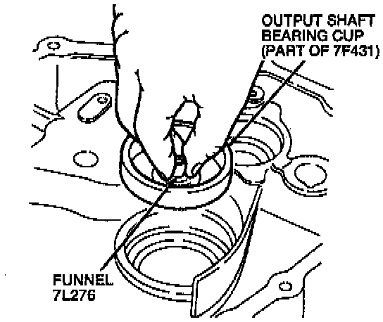

44. Remove the output shaft bearing cup and funnel by pulling up on the funnel.

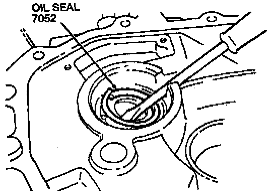

48. Use a screwdriver to remove the oil seal.
CAUTION: Do not damage the flywheel housing when removing the oil seal.

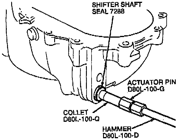

49. Use Actuator Pin D80L-100-G, Collet D80L-100-Q and Hammer D80L-100-D or equivalents to remove the shifter shaft seal.

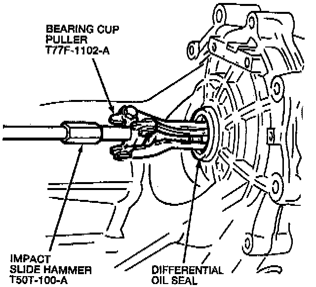

50. Use Impact Slide Hammer and Bearing Cup Puller T77F-1102-A to remove the differential oil seal from the transaxle case.

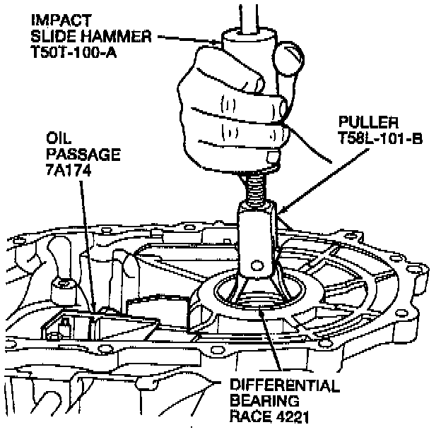

51. Use Impact Slide Hammer and Puller to remove the differential bearing race from the flywheel housing.
52. Use Impact Slide Hammer and Puller to remove the differential bearing race from the transaxle case.
53. Remove the adjustment shim(s) from the transaxle case.
