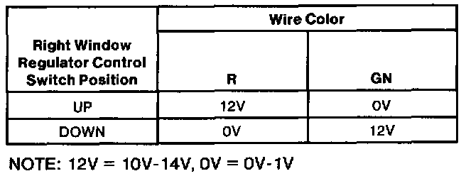

Single Window Switch
1. Key OFF.2. Remove the right window regulator control switch.
3. Leave the electrical connector connected.
4. Key ON.
5. Check that the voltage at the right window regulator control switch as specified in the illustration, while moving the switch.
6. If the right window regulator control switch does not operate as specified, replace the right window regulator control switch. Otherwise, return to the Pinpoint Test. Pinpoint Tests
