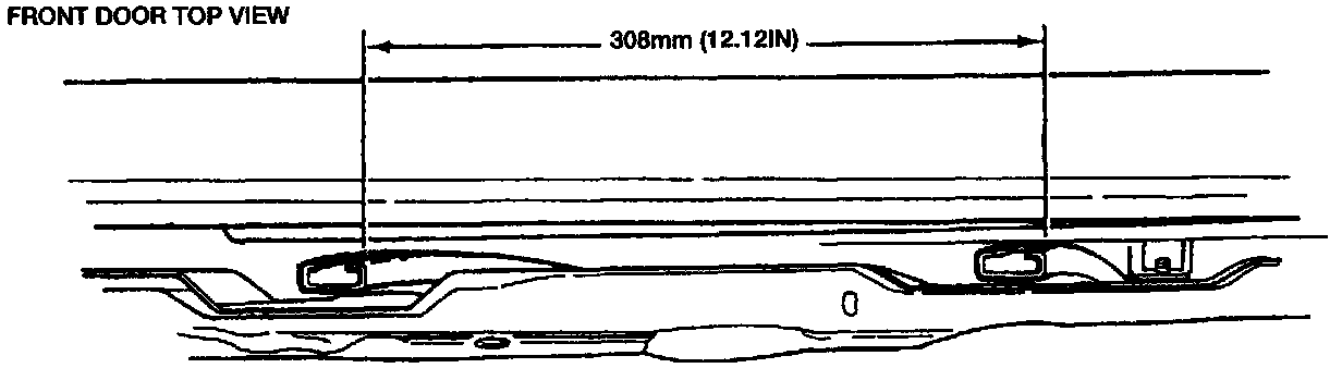

Lateral Adjustment
1. Measure from the front edge of the regulator channel to the front edge of the glass guide channel. The measurement should be 308 mm (12.12 inches).
NOTE: This step should be performed before any other adjustments.
2. If an adjustment is required, remove the front door trim panel.
3. Loosen the front glass guide and adjust to obtain the required specification.
4. Tighten the glass guide channel bolt to 10.7-13.3 Nm (8-9 Lb-Ft) and recheck.
