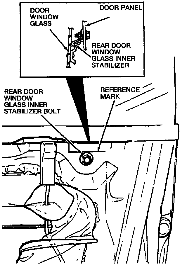

4. If adjustment is required, remove the front door trim panel.
5. Lower the front door window glass and channel 25.4 mm (1.0 inch). Make a reference mark on the front door and the rear door window inner stabilizer bolt.
6. Loosen the rear door window glass inner stabilizer bolt just enough to be able to slide the door window glass inner stabilizer. Move the rear door window glass inner stabilizer the same distance the mark is out of specification.
Example: If the front door window glass and channel is 1.0 mm (0.03 inch) too high, lower the rear door window glass inner stabilizer 1.0 mm (0.03 inch).
7. Tighten the rear door window glass inner stabilizer bolt to 7-9 Nm (60-87 Lb-In).
8. Raise the front door window glass and channel and recheck.
