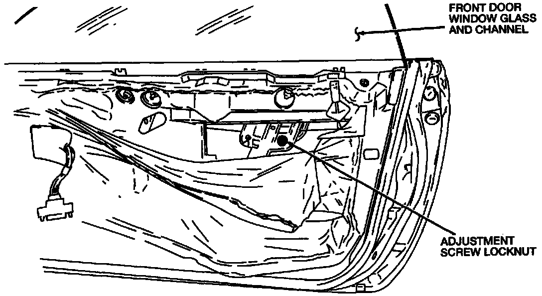

1. With the door glass in the full up position, close the front door until the top rear corner of the front door window glass and channel lightly touches the door opening upper seal.
NOTE:
- Do not adjust the front window glass and channel front inboard and outboard position.
- The specifications provided have ranges because individual vehicles may vary based on how the front door fits on the car body. It may be necessary to change the front door window glass and channel adjustments to the high or low end of the specification to correct the concern.
2. Measure the distance between the center body pillar weatherstrip surface and the outside of the front door window glass and channel. The distance must be between 14.0-19.0 mm (0.55-0.74 inch).
3. If adjustment is required, remove the front door trim panel.
4. Loosen the adjustment screw locknut. Turn the adjustment screw counter-clockwise to increase the distance.
5. Tighten the adjustment screw locknut.
6. Recheck the distance between the center body pillar weatherstrip surface and the outside of the front door window glass and channel.
7. Install the front door trim panel.
