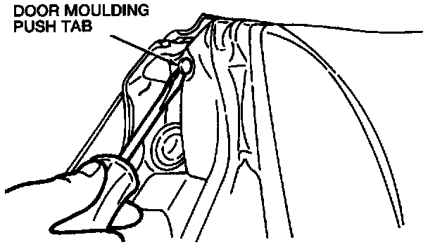

2. Remove the door moulding push tab.

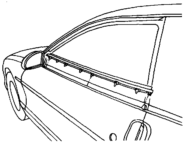

3. Push down on the front window belt line moulding to release the clips.
4. Remove the front window belt line moulding.
