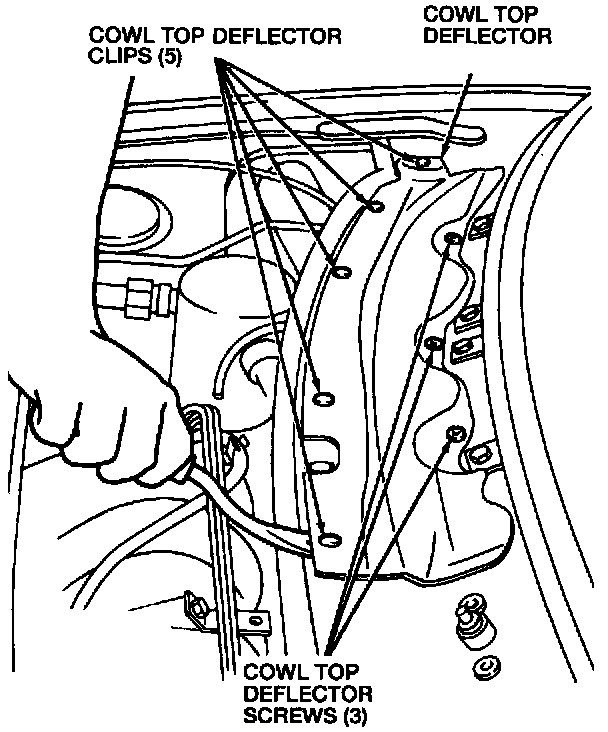

5. Remove the five cowl top deflector clips and three cowl top deflector screws and the cowl top deflector.

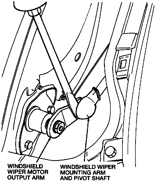

6. Disconnect the windshield wiper mounting arm and pivot shaft from the windshield wiper motor output arm.
7. Remove the four pivot shaft bolts from the pivot shaft brackets.
8. Remove the windshield wiper mounting arm and pivot shaft from the vehicle.
